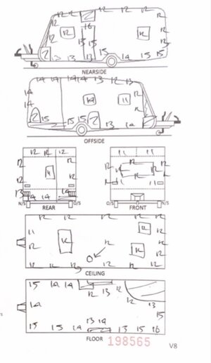

I had one of these and monitored every three months in the same areas that the AWS technician measured at the annual service. Like Hutch it q was quite close to the readings taken by tge AWS technician, so when I measured I was looking for trends. Is it going up, or down. You get variation with weather and in times when you might have been away in winter with wet weather. This was mine after two torrential weeks in Yorkshire with dogs as well.
Here’s my meter too.
6A853EA1-F8A1-481B-9C76-4B3A95BC4229_1_105_c.jpeg6A853EA1-F8A1-481B-9C76-4B3A95BC4229_1_105_c.jpeg
Reactions: Slowtow
View attachment 6921View attachment 6921
Mmm very useful thanks a lot for this! Definitely going to get one and do regular tests, now the Van is obviously "old" at 5 years by UK manufacturing standards. Not what I was anticipating but probably best, along with a very careful examination of the end panels for cracks.
