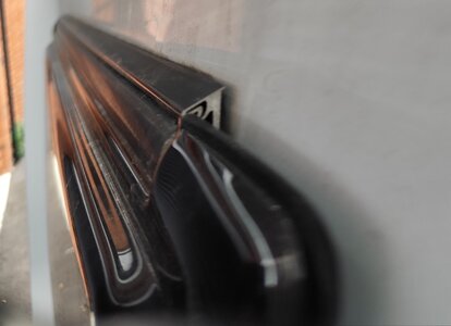

Hi, Im pretty new to caravanning, I bought an Elddis 526 Xplore this year and everything had been going great, until I noticed the back window is leaking after a heavy down pour yesterday. I think Ive located the problem, the top of the window trim (Architrave?) is not sitting flush with the caravan on one side. Ive tried lifting the window up and tightening the screw on that side but it is as tight as I can get it. Any pointers around how I could fix this would be really appreciated!

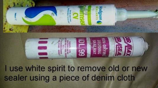

I would lift the window from the hinge bar,, remove screws and then remove the hinge bar. Clean off old sealant and replace with new mastic strip. Replacing the screws with some new stainless steel ones.
