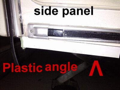

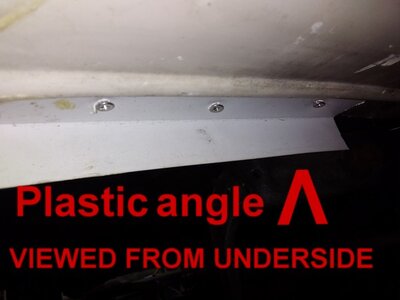

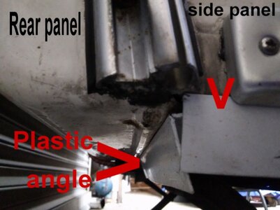

Sometimes where the lowest part of the awning rail Meets the end panels run of water collects in the corner sections of the floors.. I've used a piece of plastic angle to interrupt it's flow and deflect the water so it misses the floor and drips onto the ground

I believe that when Bailey's of this age were produced there was a peice of plastic sheeting "caught" between the floor and side/rear panels on the corners to prevent water getting into the floor. That plastic sheeting (think fertiliser sack) becomes brittle over time and cracks. The result isn't too difficult to predict

Thank you very much for the reply, your description is perfect, it just looked as if it hadn't been finished off neatly, when i touched it it was brittle and just broke up and fell off. in the corners it looks like the "drain" where the water comes down needs extending below the floor or a curved piece of plastic added just in front of the wood corner so the water misses the wood. i might try putting something between the rear wall and the floor as well.
