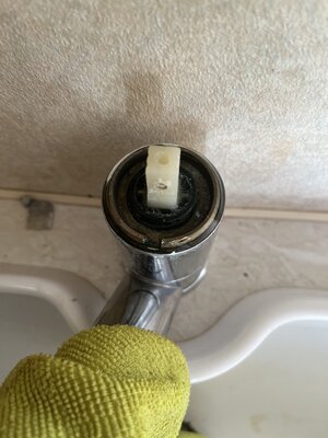

M Modestadventurers Apr 14, 2025 1 0 10 Monday at 10:36 PM #1 Anyone know how to remove this type of tap cartridge? Attachments IMG_0964.jpeg 1.7 MB · Views: 12
Jcloughie Jun 16, 2020 5,327 2,305 11,935 Monday at 11:24 PM #2 Welcome to the forum. Remove the circlip from the top prising with a small screwdriver. The cartridge will pop out. There should be a number on the side which can be googled. Or, go to a caravan shop and pay 2-3 times as much. John
