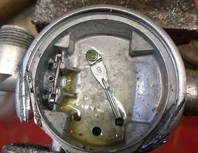

Its either oil in the regulator or in the lines, this oil is known as 'heavy ends' its a byproduct of the refining and compressing process . Things to note with gas bottles
1. if possible never lay them on their side and if you have to, allow 24 hours stood upright before connecting up.
2. The regulator should be higher up than the outlet of the gas bottle(s) to allow the heavy ends to drain back into the bottle.
3. As you live in the caravan, have you or the site owner connected up a large 47kg bottle to your caravan ? if so then you have broken rule 2 , also I bet the bottle is free standing which just an incident waiting to happen - get it chained up.(note if the bottle outlet is above your caravan regulator this problem will keep reoccurring. You need to get an inline filter / oil trap fitted.
A mobile engineer will quickly be able to ascertain the problem by attaching a manometer to a test point and running your appliances .
attached is a photo of a failed regulator which I cut open ( because I'm that way inclined- I hate a mystery!) which shows the oil build up. This regulator was less than 18 months old and was fitted to a camper, which he had refillable bottles and always refilled at the same garage so I presume their filters were compromised

The regulator issue was separate; had gas coming through but as soon as you increased demand the gas pressure died. New regulator supplied under warranty.
