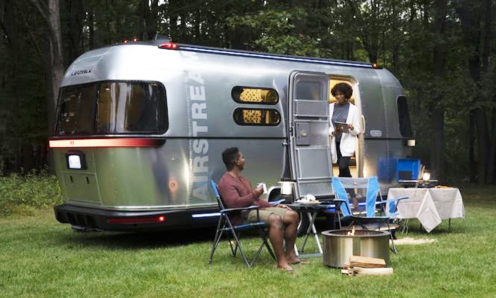

So Airstream have a proof of concept of a caravan with an 80kWh battery and motors built in to help with range when towing with an EV. Looks interesting!

It has 900w of solar on the roof. That would trickle charge the batteries over a few weeks, rather than drain them.

Tobes, once again thanks for the interesting information. I would guess that with 900w solar panels plus the batteries the caravan must weight a lot more than most SUVs could tow.
However I was thinking more that if UK manufactuers adopted the idea we may have a similar scenario with UK caravans and weight.

North American vehicles such as the F150, Rivian and Ram etc have much larger towing capability than European vehicles. Airstream have always been designed for the North American market, any official entries over here didn’t do well, but you do see a few around. Like this one parked up next to us homeward bound from Santander. Chatting with the owner the Bentley did tend to overheat on some Spanish passes but nothing that a quick stop wouldn’t fix 684E2BF6-63ED-471E-AC17-0B085BDBC2B0.jpeg
