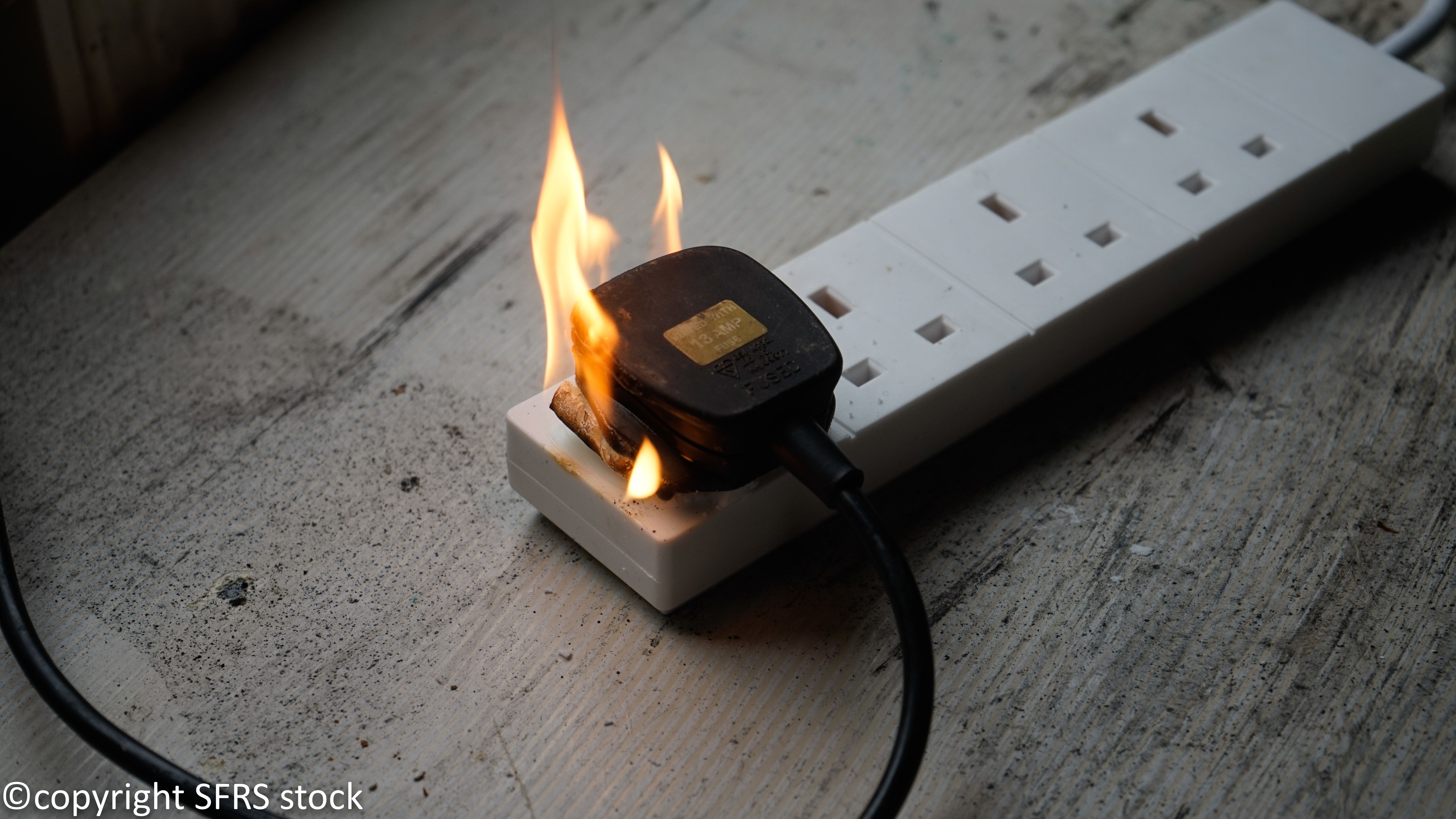

Don't believe me?
How about the London Fire Brigade.
Or Dorset and Wilts Fire and Rescue
Or Staffordshire Fire and Rescue
Running a caravan from a 13 amp socket is like having an extension lead with equipment capable of drawing 20-30 amps plugged into it. Perfectly safe if you are aware of the individual loads and use them sensibly, but easy to overload if you aren't. The risk of fire won't be in the caravan, it will be at the point it's plugged into the 13 amp socket.
20,412
5,564
Don't believe me?

I don’t agree that the longer you overload the plug the hotter it will get. The PAT link above gives details of the effects of overload on 13 amp plugs and fuses. The plugs are designed to dissipate heat and gradually warm without detriment. So you would expect the temperature to plateau out for a given load,but not be at a level that creates a fire. The fuse should go before that happens. Of course if anything is wrong with the plug by manufacturer or owner actions then the risk increases. But that could be the case in other alternative powering solutions, and the home protection hasn’t been discussed. But I guess that different views and experiences make this a circular discussion. But like you I certainly would not advocate pulling in excess of 13 amps and the Fire and Rescue bulletins give good advice on how to calculate load.
Oct 19, 2023
639
510
2,135
Take a closer look at fig. 2 in your link. Did that plug gradually warm without detriment? Is melting not detrimental? Plastics are generally very poor at conducting and dissipating heat.
The plug looks like it might be ABS which has a melting point of 190-270 degrees C. Paper has an ignition point of 233 degrees C.
The vast majority of domestic premises in the UK are wired with 30 or 32 amp ring mains , far more than can be safely conducted by a single socket and 13 amp plug. They may be MCB and RCD protected but they won't trip if you draw 30 amps from a single socket.
