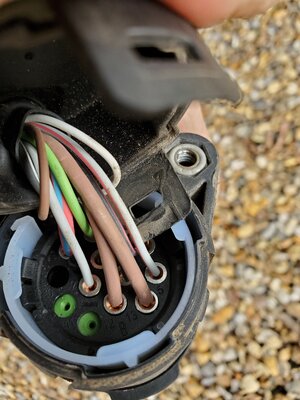

Having recently bought a 2015 BMW X3 with factory fit electric swivel towbar, I have found that I have fallen foul of the BMW lack of wiring for the fridge. So my socket has no female wiring to pins 10 and 11, nor even female metal sleeves for those pins. I have reviewed loads of threads on here about this, mostly they are quite old. But nowhere have I found any info about what, if any, metal sleeve is available to insert in the plastic socket casing. That would enable me to wire in a fridge/split relay direct from the car battery that is in the boot (by-passing all the compications of BMWs other socket wiring). I think I may have found a female connector that could work.
But before trying that I am asking if anyone has any recent experience of fixing this problem (probably on other BMWs also) either DIY or using an expert fitter?

I had the same on a 2016 BMW520D, back then BMW could supply a replacement socket and loom but the cost was eye watering, I’m lead to believe it is no longer available. I didn’t bother in the end as only had the car for 3 years. I did ask an independent fitter but (from memory) the existing BMW loom was factory fitted into the socket meaning replacing the socket onto the existing BMW harness and adding additional fridge wiring wasn’t straightforward.
This was a few years ago so try talking to someone like PF Jones who produce vehicle specific looms for tow bars.

I have a BMW factory fit towbar on a late 2019 X3. I do have the required pins. However, my fridge does not work as it seems that it is not getting enough power. I assume this is loss over the wires in the van as at the towbar it is sufficient. This seems to be fairly common with the tall Thetford fridges.

Milkfloat - Are pins 10 and 11 wired in though? If they are your 12 V power to the fridge will be due to the "smart" alternator reducing voltage output to only keep the the battery at about 80% charge. The result can be insufficient voltage to run the fridge.
Yes - they are wired in and the fridge does not work even when the alternator is having to work hard. Lights on and battery packs being charged.

I have a Sterling Wildside caravan specific battery to battery charger fitted in the caravan, its main function is to combine the pin 9 and 10 feeds from the car to optimise battery charging or fridge operation by ensuring the voltage and current supplied by the car are at the optimum values, over coming the deficiencies of the Euro 6 alternator. It has an additional Wildside function that allows you to operate the fridge from the leisure battery. Baring in mind the absorption fridge will draw 9-11A continuously that can rapidly deplete your battery especially if it's a lead acid. I do use the function for maintaining the fridge whilst on a ferry crossing of a few hours knowing that I have a 125A LiFePO4 battery and the battery will be being properly charged when towing the other side.
For normal fridge use I would go see an auto electrical and get them to run a suitable 15A feed direct from the battery to the trailer socket via an ignition switched relay. `it probably won't be cheap on labour as they will have to dismantle lots of trim to run the +ve cable

I had exactly the same issue on 2017 Porsche Cayenne, also with a factory fitted electric swivel there was no insert to fit and Porsche make things very difficult for third party companies to touch factory fitted equipment. I had to bite the bulitt and have a new plug fitted very expensive but works fine.
