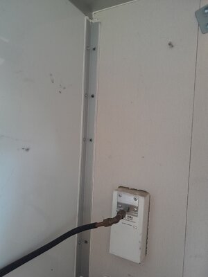

Hi I have a Compass Kensington 554 based on Elddis Avante. My problem is that the front bulkhead rivets have sheared off.
The rivets are on the side wall of the aluminium bracket. The other side of the bracket has self tapper screws and they are fine.
This is a common problem from what I've read.
My question is what do the rivets attach to and has anyone replaced them with new rivets or with self tappers?20250628_134314.jpg

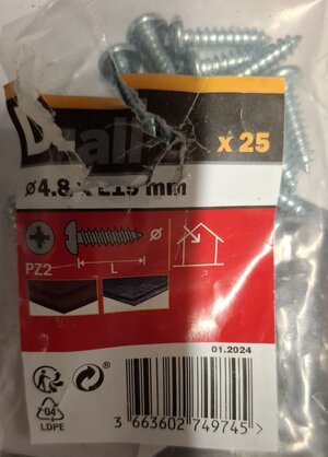

Mine had self tappers to begin with. When some of them fell out I replaced them with rivets. Some of those rivets sheared off so I have replaced them with larger diameter self tappers. I haven't used the van since doing that a few weeks ago, so can't comment on the effectiveness

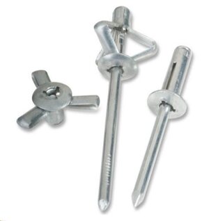

the rivets shearing off suggests the front and side walls are flexing against each other which is worrying. Elddis tend to use split pop rivets as below

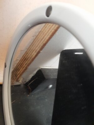

Rich are we screwing into wood or sort of insulation.. I've taken a photo via a mirror of a side view. It shows wood behind panel but not sure how far across the goes. It might just be a baten
I think the screws just go in to the board.

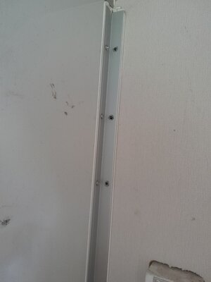

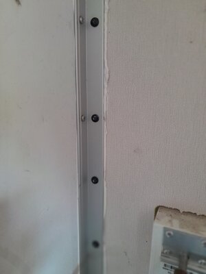

I've attached photos of before and after

Double the number rivets with larger ones and Steel ones.
If the holes are not drilled the same size they will move and allow the panels to chafe.
Replace the screws with steel rivets.

Some of the screws I put in fell out after one trip.
I've got some of the split rivets suggested further up the thread to try next.
