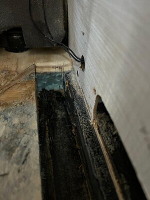

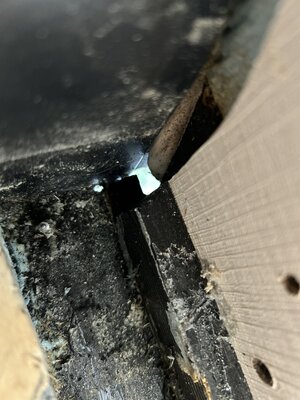

Hi everyone, apologies if this conversation has been talked about before but we are new to caravan life. We purchased our 5 year old Caravelair Anteres 480 about 3 months ago, we had done quite a bit of research on caravans and this one seems to fit us perfectly. Not knowing exactly what we were buying, on the face it looked perfect, a few minor cosmetic things that are easy to fix. On our first trip away we noticed that there was a small section of flooring that was a bit spongy and immediately suspected some kind of rot was occurring. Being quite handy wit tools etc we decided to pull up a section of the floor covering and found the ply below was rotten and spreading. We have now removed athe section of the ply that is rotten and also the soft wood timber that was rotten too. This will all be replaced when everything else has dried out.
When all the rot was removed we started to investigate with a hose to find where there water coming in, checking the usual places around the window and roof line but nothing, then we moved to the plastic wheel arch!! Hey presto there is a gap about 20mm x 10 mm between the wheel arch and the caravan floor, water was just pouring in. This has now all been sealed very securely with MS polymer and no further intrusion of water coming in.
The problem we have now is although all the rotten timber has been removed to a point where the timber is sound this timber is still wet from all the previous water that has come in and still sitting around! We have had a dehumidifier in the caravan now for 3 days and so far it has removed approximately 6 litres of water from within the caravan. I’m hoping that this will eventually draw the remaining water out of the timber before we lay new ply and re lay the vinyl flooring.
My question is has anyone had success wit a dehumidifier drying out wet timber in a caravan?

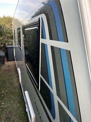

On going from this we have now removed all the mastic from all the windows and hatches etc and renewed with MS polymer which now looks like new.

Congrats on your purchase. Just a shame you got caught by an unscrupulous seller which is why it is normally best to buy your first caravan from a reputable dealership.
The dehumidifier removing the 6 pints is no indication of moisture inside the caravan. As the air inside the caravan is dried it is replaced with moisture from outside as the caravan has numerous drop holes.
Having had a flood in my caravan, that was an overnight thing so very little water soaked into the floor, I can advise that it took in the region of 7 days for a dehumidifier to dry the floor out to 15% water content. So it's going to take a fair bit longer I think in your case. I woukd advise you to remove all (or as much as you can) of the vinyl as tge damp will have tracked across pretty much all of the floor and if it's covered it cannot evaporate out of the wood.
Is that visible floor actually plywood covering foam? I ask because it looks like OSB not ply and caravan floors are not manufactured from OSB. (OSB Opposing Strand Board surface looks like large flakes of wood, not veneer

Hi, the flooring is 9mm Garnica plywood with blue foam insulation panels below and seems to be bedded on an aluminium sheet forming the underside to the chassis. I have very carefully removed the ply surfaces layer by layer leaving just the thin veneer before the blue insulation so no damage to insulation.

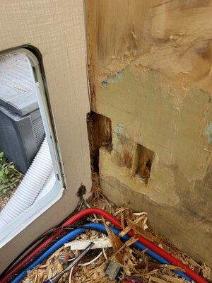

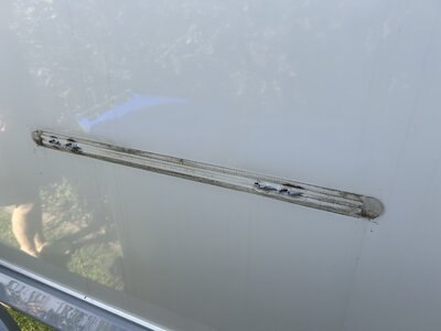

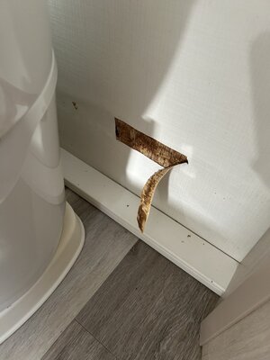

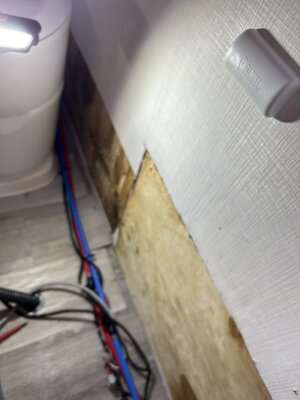

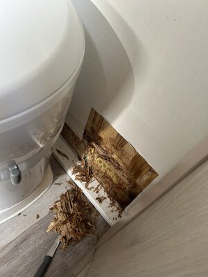

Hi all, quick update with on ongoing water ingress investigation 😫. currently starting to dismantle the bathroom to start trying to sort out this mess, seems this caravan hasn’t been built with any care looking at all the problems it’s having now!!! the seems easy to avoid with just a bit more attention to the amount of sealant used around holes going through the bodywork, the rear ingress issue was the bike rack not sealed enough around the bolt holes.
Think the next few months will be taking up with this one. Thinking that the toilet will have to be removed and possibly the shower😲. Well learning a lot about caravans with this one and if we get another we will know what to look for before being duped into buying one like this again.

I can't comment about French Caravans in general, but part of the reason fo what you have found, is the wall boards used , have a vinyl "paper" which of course is impervious, which means a lot can be going on behind the covering well before you get any visible signs. hat alert you to it.

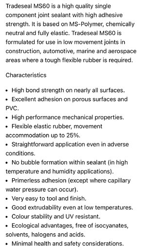

We are using a hi quality MS polymer adhesive sealant to re seal all the windows- skirt rails - light casings. Practically everywhere. I believe this adhesive is used for bonding boats and is flexible and uv resistant.
