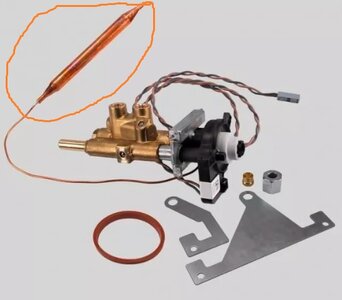

I'd be tempted to retrofit a secondhand Truma, as I don't think my budget will stretch to a brand new unit + installation. I did a little scouting about on ebay, but I only seem to be finding the Truma S3002, which looks like its capable of cycling on and off on electricity, but only has a low/high numbered dial for gas? (or I may have misunderstood!) Would you know of another Truma model that can hold a chosen temperature on gas?
The truma S3002 has a room 'bulb' sensor located at the bottom of the fire( where air gets sucked in and and over the heat exchanger and out the back by the fan ), this is part of the gas valve and when it warms up it will start to close the main gas valve to a minimum flame, The numbered dial sets the initial flame level 9 so sort of sets the heat up speed. Its not a true constant temperature control but does provide room temperature feedback The carver 1800 may not have the room 'bulb' valve ( only worked on the Truma units ( which look so much like the carver-in many respects) so I would suggest Truma improved the control of gas valve . Note the Truma normally vents the exhausts out of the top of the caravan , whereas the Carver vents through the floor, Don't see venting the Truma through the floor.If the Carver gas valve has the 'bulb- highlighted in red on attached photo, it may be covered up or broken(capillary damaged) , so its not picking up the room temperature, so the gas valve stays fully open. It may also be possible ( by a qualified gas engineer) to fit the Truma gas valve into the original Carver assembly
Both Carver and Truma of that era had a variety of exhausts - underfloor, sidewall or roof
