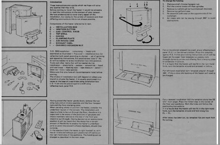

I don't have much tech notes on the 1800,the bottom image is from a 3000,I believe the 1800 vents from the underneath the caravan/motor home,never had a 1800 so I can't be certain,hope however you get it up and running safely01_084830.JPG

The basic 1800, as shown above, had both inlet and outlet under the floor but there were versions where the inlet was under the floor but the outlet went through the wall or the roof - I believe there was also a version suitable for boats where both inlet and outlet went through the wall.
