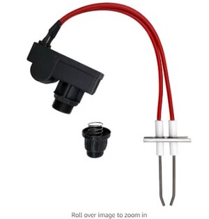

Welcome to forum. The Truma unit is a rebadged carver 1800 ( truma took over carver , prof has more detailed info on this ) then developed the S3002 , there are two ways to get at the spark electrode , but before that if you remove the front panel the unit may not spark as the piezo requires two connections , one is actually connected to the front panel , which needs the front panel to be connected to the main chassis , also the spark can be difficult to see through the window. To get round this I carry a battery powered unit which I connect one output to the original wire from the piezo unit and the other to the chassis. The battery spark unit can supply about 10 sparks a second which allows you to view the spark better , also it will start the pilot jet more consistently and allow you to check out the rest of the system. One point to note is that to work on a gas appliance you really need to be qualified, another point is if you do remove the unit , then the gas line will need disconnected and again it needs to be done by a qualified person particularly when reassembling.attached is the photo of the gas ignitor I bought as I got really cheesed off with the piezo ignitor. The more modern Truma S3002 have auto igniters which trigger as soon as you turn the gas valve control .
