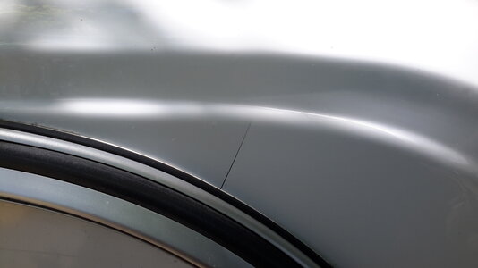

Check front end high locker leaks for damp areas, as have been several posts this last 12 months on 2017 to 2019 Coachman’s leaking on more than one forum.

If it is the mid bathroom with the curved , sliding , Shower door, check the top brackets for cracks,,in the plastic.
The rear panel near the top lights for cracks. Coachman do not admit to fitting the awning rails without pilot hole drilling.
