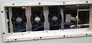

Hi we’ve had our caravan for nearly 4 years now and never been happy with the performance of the fridge when the weather is hot and or we’ve put an awning on. The freezer box never really freezes .
It’s got the Dometic series 10 fridge fitted and I was wondering if fitting the optional Dometic fan kit would improve the performance in these conditions.

I believe the "ice box" in these fridges is removable and sometimes they get dislodged slightly so don't cool down as much as they should. A quick Google search shoukd point you in the right direction on that.
If that's not the issue then yes fridge fans do help a lot. It's a pretty simply DIY job to sort your own fan system out without buying the expensive "kits"

Do you remove the exterior vent covers when pitched up?
Seems your fridge vents into the awning?
If so then yes , fitting fan(s) as suggested by Mr Plodd should help, assuming the freezer compartment is correctly located and the door is sealing ok.

The freezer box is firmly located and sealed we had to get a dometic engineer out to re attach the ribbon cable on the back of the control panel, he put a sealing strip to fill the gap between the freezer box and main body.
I’ll definitely look into fitting fans though.
