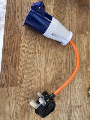

We picked this up off Amazon to connect the van to household power (we have an outbuilding where the power socket is protected from rain so I think this looks okay).
Has anyone experience of using these adapters and is there anything to watch out for?

Yes I use one often. The only thing to potentially watch out for is drawing too much current from a 13 amp plug/socket, but you'd have to have both the caravan heating and water heater on to go over 13 amps (or other things plugged into the caravan supply, kettle, fan heater etc.). Very handy for keeping the leisure battery topped up, or cooling the fridge before you set off if you want to.

If the plug is fitted with a fuse then it would blow the fuse first 🙂
I afraid that's not true. A BS1362 13 amp fuse will conduct 20 amps indefinitely. At 20 amps the plug and socket will overheat with the potential to ignite any flammable material close to it before the fuse blows. Overloaded sockets are a major cause of house fires in UK.

Not necessarily.
Conventional cartridge fuses need enough current to cause the fuse wire inside the fuse to heat up to actually melt the fuse wire. As the system is rated for 13A continuously (i.e. the fuse should not blow at 13A) the fuse must require more than 13A current to actually blow. Depending on the quality of the fuse, some sufuses can actually sustain twice their rated current before melting. MCB's ar far more sensitive and will provide better protection.
As for the current the socket can supply, that will depend on how its wired to your domestic system, and how the circuit is protected. Modern properties are being wired with radial power distribution, which means sockets are wired back to the consumer unit individually. their current limit will be set by the MCB feeding the circuit.
Older UK properties were wired with ring mains, which means current can reach a socket from two directions. Most ring circuits are set up with 32A MCB's so theoretically you could see 32A available at any ring socket.

If the supply is from an independent garage (as distinct to one that is part of the house) it should have its own power box with an RCD, 6A MCB for lighting and either 10A or 16A MCB for power. As an MCB trips significantly quicker and at lower overcurrent it would be well safe.
I think should and could are the operative words in your post.
Yes an mcb will trip quicker and at a lower current than a fuse typically blows, but not 'significantly' quicker.
BS EN 60898-1 stipulates that a 16 amp mcb must not trip within 1 hour at 1.13 times its rated current, and that it must trip within 1 hour at 1.45 times its rated current. The 16 amp breaker that might be installed in the op's out building is not required to trip at 18 amps (ever) and could conduct over 23 amps for almost an hour. I have no idea how hot a 13 amp plug / socket would get conducting 20 amps for an hour but I wouldn't be surprised if it was so hot that you couldn't touch it.

Not sure where you are, but I'd hazard a guess that you have radial circuits with a lower current rating than our ring mains, 15/16 amps rather than 30/32 amps? This only partially answers the question as the cable to your electrical devices would have to be capable of carrying 15/16 amps so do you have 1.5mm cable on all your appliances? You obviously have adequate protection but you'd need to speak to an electrician / electrical engineer with knowledge of local regulations to find out how its implemented. Having said that, I've often wondered how some of the hotels I've stayed at outside uk (especially in Greece) haven't burned down.

I am aware of at least two over the years being mis wired. Best open the plugs and check before use

Further to Dusty's comment, I have actually come across a 13A to Ceeform adaptor which had failed. It was purchased from eBay and was used without a problem for a number of months, but then it stopped working. The fuse was intact.
When I inspected it, I noted the cable was not as flexible as I'd expect, and there was a kink in it. There was no obvious signs of a BS cable marking.
I dug a bit deeper, the live conductor in the cable had fractured, and the few strands that had remained had obviously over heated and melted, but the melting was different to most damaged copper, and that's because it wasn't copper it was copper coated aluminium.
The Ceeform connector was also not to standard, the plastic was quite brittle and it had sustained a chip which I believe a full spec one would have survived
The world is being flooded with cheap inferior goods, often being missold mainly through online auction and hosting sites. I urge people to be very careful about buying items like this from popup sellers. They're cheap for a reason.

In my industry we are seeing this more often on LV distribution networks and also switchgear, but the limitations of copper clad aluminium are taken into consideration during design. Unfortunately cost-cutting unscrupulous manufacturers are simply using it as a cheap alternative!
