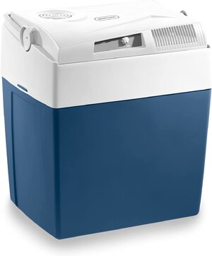

We had this one for some years now
Mobicool MV30 portable cooler 29litres 12v /230v
Cools up 18 o C below ambient Temperature
Fast cooling with it double fan
So far we find it great
