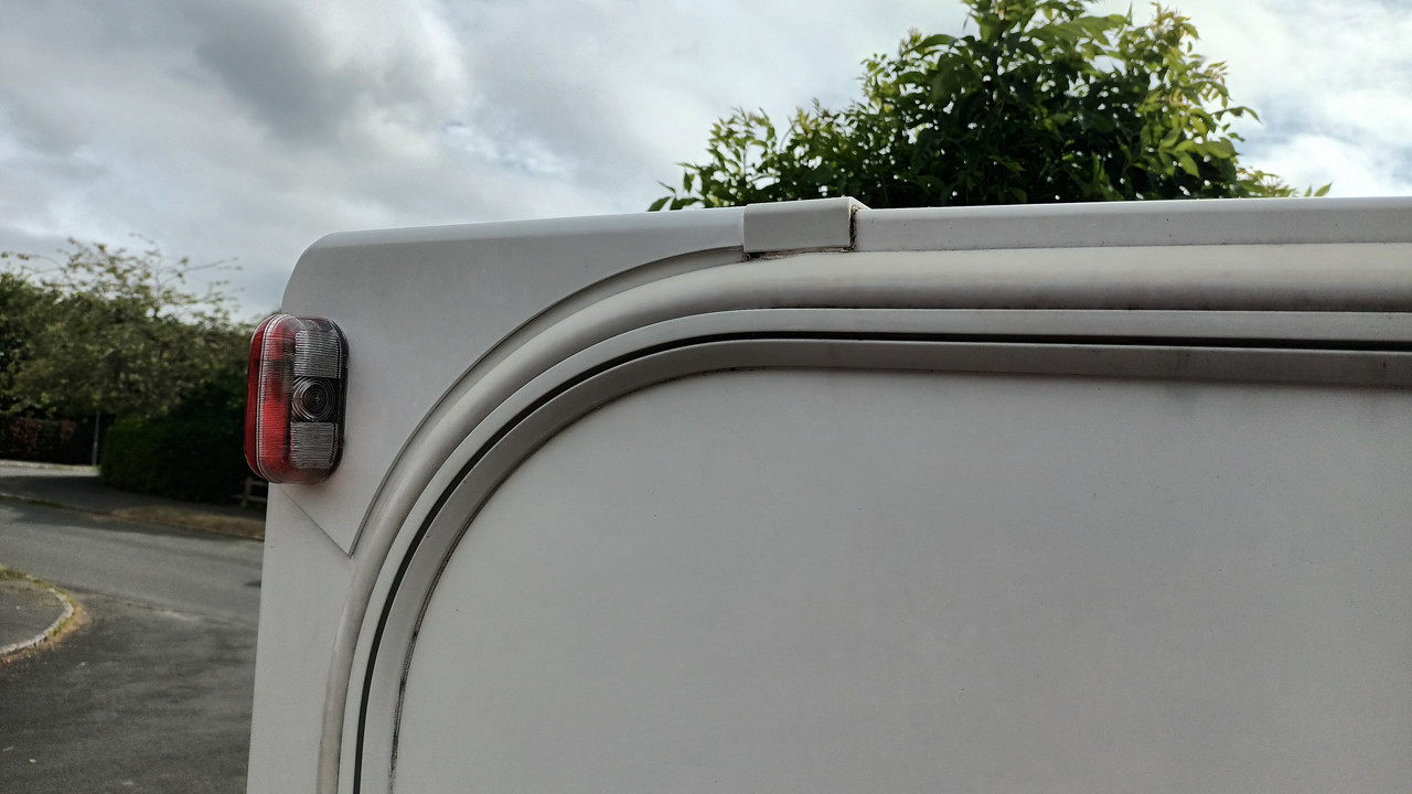

.......at 9 years old my Swift Challenger developed a 5cms crack on one rear corner on top of the roof. This is a known fault with Swifts and they produce a kit consisting of a pair of roof rear end caps.
Fitted the caps myself to each side to give a balanced finish.....the rear top lights had to be removed and refitted over the caps!
No help to forumites with more serious faults in this thread I know...but a good outcome for me at the cost of £45.
If I didn't know better, I would say that 's my Challenger. Bought the van at just three years old and both sides showed 2" cracks after two months, the dealer fitted these caps, free.
Before the cap was fitted the dealer stopped the cracks by drilling both ends then ensured that they were filled with, I believe to be Sikaflex, then the caps fitted as above. That is coming up to 7 years this October. Jobs a good un.
