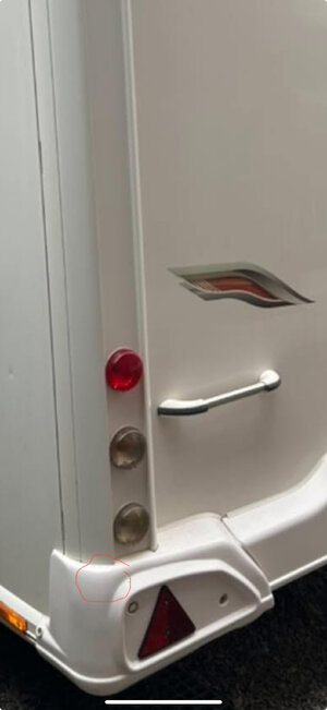

If a corner has crack in red circled plastic as shown in picture, does it cause damp on the floor of the corner?
Its impossible to say yes or no based only on photograph.
But it has to be a possibility especially as it's in the correct vicinity.
12,390
4,547
Fully agree with the Prof, but I thought the bottom corner bits were just decorative covers.
Hi Kai.
What model and year is your Bailey Unicorn?
The photo,ringed in red , you show of the rear is the caravan rear cover panel..
Depending on the year It will not be part of the main structure , just a decorative cover panel. I doubt a crack will be responsible for water ingress.
The well documented water entry point on Alu -tech models is a failure of the sealant at roof awning rail , roof joint panel seam or there abouts. It cascades down the inside walls reaching the floor internally , hence the damage seen by quite a few over the years.
Bailey knew of this problem over ten years ago. The first line and only line of water defence is the sealant. Incorrectly applied the inevitable happens. Shame they can’t make a mechanical water tight joint as the primary defence , sealant second defence.
Basically another caravanning example across the board of poor design not remedied🤬

Hi Kai.
