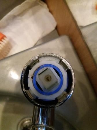

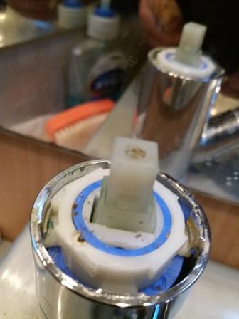

I am replacing the microswitch on my Reich bathroom mixer tap. To get the wires down the inside of the tap body I will have to remove the cartridge, but am struggling to find out how. All the details I have found refer to a brass nut within the body. My innards seem to be all plastic, with a blue retaining ring. I will try to post a picture. Any suggestions?

Photos now visible and detailed and if I reply your post goes to the top and may generate some more replies for you! Indeed I have replaced the cartridge in one of my mixers, but it was held in place by a large brass nut that screwed inside the body of the tap as you described. By the look of the photos yours may be held in place on a 'bayonet' principle and twisting it a few degrees would allow it to lift out. Do you know the exact make of tap as manufacturer sites often contain 'exploded' diagrams, or with that info you could give a supplier a ring for advice.
