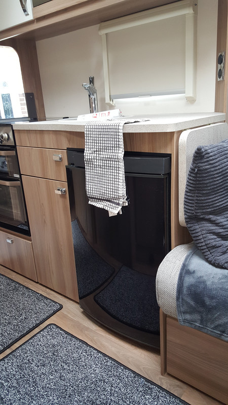

Is there a fault with your fridge light or do you just not like it in general ? Mine doesn't bother me but even if i leave it open 30 seconds the alarm goes off in the fridge if it's left open but when it comes to a night time even though the blue LEDs on the front are bright I just drape a tea towel over the bench over them so the place isn't illuminated !

Tea towel like my example ! :p
It just so happens that mines on the drive and able to show you

I only cover it because where I lie on our bed i face the fridge but once covered the room is blacked out .
