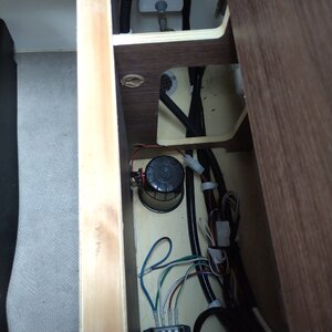

I'm going to attempt to post a picture of what I think the noise is coming from.

Wow. It worked.
It's that black looking thingy I'm almost sure.
No power to the van .
Battery off.

It's not unusual for alarm sirens to have their own rechargeable battery as a protection against tampering with the alarm wiring - it's possible that's dying, perhaps because you've disabled other parts of the alarm.
