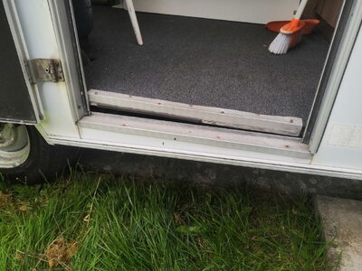

Hello- my partner and I bought an old (possibly late 70's?) Eccles Elan 12 caravan.
We unfortunately have found various issues having got it home which weren't apparent in the listing.
One I am particularly worried about is the gap from the floor to the bottom of the door frame. It's about an inch or so and appears as if the outer wall has dropped or the floor has lifted in that area.

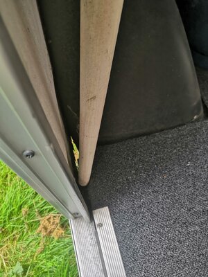

There is also a gap between the floor and the wall, about an inch again where the wheel arch is and appears to have come away.
getting underneath, the rest of the wall seems OK- it's not detached and no gaps. It's just this area, about a meter in length.
Have shared images, hopefully these make it more obvious what I am trying to explain!
Any advice/knowledge would be greatly appreciated, thank you

Looks like the joint twixt the wall and the floor has failed, and the sidewall has dropped (the floor cannot fall upwards) probably due to rot in the timber frame caused by water ingress over an extended period
It looks like you have a pretty major repair job to do to both the sidewall and the floor. Unless you are very competent at DIY the repair costs will almost certainly vastly exceed the value of a 40+ year old caravan.

Is that daylight through the crack in the second photo?
What’s the floor and chassis mounting points like underneath?
I’m with Mr Plodd. This is a long term deterioration of the structure resulting in the floor moving away from the walls .Is the floor level without humps bumps?
There is a possibility the floor may have delaminated , moving upwards. But it is a very large gap!

Sad to say unless your into restoration, and what you are going to use the caravan for. Kids to play in at the bottom of the garden, I would be trying to get my money back.

I fear you have bought a pile of (potentially very expensive) grief here. Caravans from 40 years ago had a pretty limited life span, 20 years being exceedingly optimistic, especially when you consider the materials used back then.
Personally I wouldn't consider towing it anywhere until I identified, and rectified what appears to me to be a VERY serious structural failure. It looks like it could indeed fall apart on you.

Anyhoo I'd have a go, first I would work back long the timber of the floor underneath to find somewhere sound, then get some really strong ply sheets and and effectively make a new secondary floor piece underneath. Then I would get some angled aluminium decent gauge stuff with holes in to begin the process of bringing the wall up back to the floor. After that using some aluminium sheet and sealant apply a new water-tight edge to places it has rotted through.
The problem I can see is that if one side has dropped then the other side may be close to going too or of course all the closures etc will be out of plumb so likely points of water ingress.

Looking at the above images I'd suggest checking the surrounding floor near the door frame..it may be a simpler fix if it is a one piece of plywood rather than a composite Good luck Gary

Oddly we had a similar issue on a 2 year old elddis, but not quite so extreme movement, but 2 metres of one side separated from the floor. We could also see daylight.
The solution was very similar to the process Deejuk described with use of heavy aluminium angle, lots of screws / bolts and mastic/glue after they jacked the side up level with the floor again.
However the repairer was working with sound materials, it was the SoLiD construction joint that failed. I can't say if it lasted as we traded it in as soon as the repair was done.
