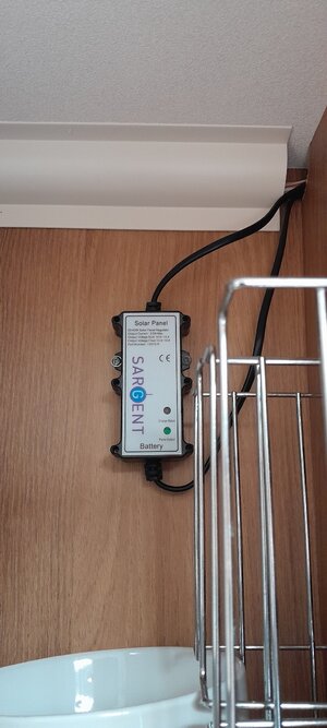

When I'm on EHU is the solar panel shut down completely, only there are no lights at all on the regulator when I'm on the ehu, and when I leave the site and turn the system shutdown off, there still is no lights on the regulator.

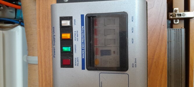

The green charger light stays on the rcd unit with the system shutdown off.

Can you tell us what type of regulator you have?
If its a decent solar panel controller it should stop supplying the battery when it's fully charged. On EHU the battery will be kept fully charged from the caravans charger so the solar panel won't be doing much. Can you turn the caravan charger off for an hour and see if the solar controller cuts in?

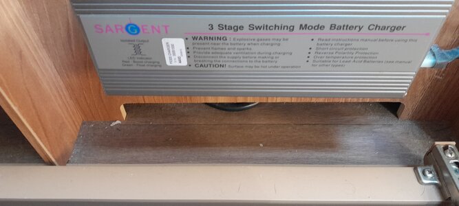

Hi Beardy, see the above pictures I've added it's a Sargent 15575-R, I'm away from the van but I'll try on my next visit thanks
Crossing messages 🙂.
Did a quick Google search, someone has quoted a section of the manual here, it stays that if the battery is fully charged or the charger is turned on the regulator will turn off. Hopefully you don't have a problem. 🤞
