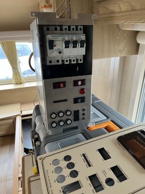

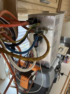

Evening all
All electrics are now working on the Caravan. Found a replacement control unit for £80 from Staffordshire Breakers and everything is A+. Would recommend, as paid and delivered in less than 48 hours!
All hinges have been replaced for cupboard doors. Total outlay now at £86 - chuffed

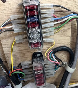

Photo of fuse box top , rear lights 12n plug on other end of black 7 core flex,other fuse box from 12S plug on the other end of grey cable

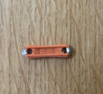

Fuse shown is what was used after glass but before blade fuses they are known as continental fuses,,I would replace it with a new blade fuse and fuse holder
