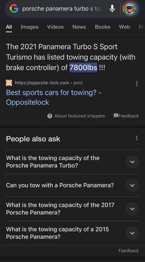

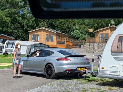

Our neighbours last week in Somerset, apparantly can tow up to 7800 lbs or just over 3.5 ton

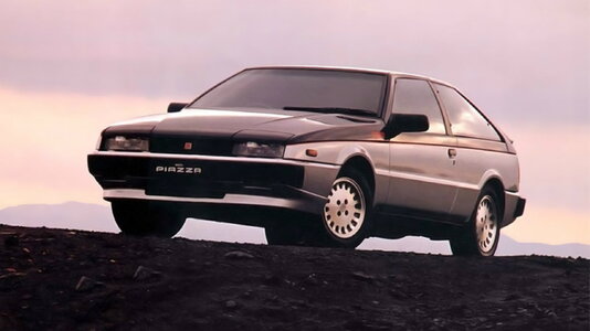

5,835
2,755
I used to tow with one of these and it was first class. A 2 litre turbo. Not as powerful as the Porsche. But not what most expect to see pulling a caravan so turned many heads. Heavy for a sports car with a very small rear overhang. And the library picture was the same colours as mine.
I genuinely looked at one 2 years ago but decided the job with the big salary was likely to kill me so jumped ship! The petrol and diesel Panameras are rated at 2200kgs towing limits, the hybrids are zero. The other issue is that “tow bar prep” is a cost option when new (£175 from memory) and not many folks opt for it so adding a tow bar as a retrofit isn’t easy. Fantastic cars though!!!!

That must be a trick photo, can't see any rain!
Oh believe me Woodsieboy it wasn't like that all the time, we still had our fair share, it teamed down on one night, it kept me awake!!
And that was it, perhaps my luck has changed 🤞
Reactions: woodsieboy
Hi Gary, son sent me this when I sent him the pic, not that it makes much difference, and converted into ton is just over 3.5t

19,237
4,411
If the towing weight t is quoted Lbs, it will be an american specification. Legally in the UK and EU, the maximum towing weight of any braked trailer that is permitted to be towed behind a car is 3500kg,

The fact these are specialist vehicles means they are not normal cars. The OP's picture of a Porsche Panamera. is an EU model and as such would be limited to a trailer not exceeding 3500kg.
Again I'll point to the fact the OP's posting referred to the towing weight in Lbs not Kg, and that almost certainly points to a vehicle sold in the USA, and its technical specifications concerning towin may be quite different to those in the UK and EU.
