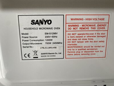

Had a lovely first break with the wife and kids in Blakemere Holiday Park near Northwich. But unfortunately the Sanyo micro gave up the ghost after a pop, smoke and no signs of life.
I’ve been able to take the Sanyo out, no problems, so I’m now looking for replacements. Read a few suggestions and have decided to go with a bog standard ‘residential’ microwave - 700w and pretty much the same size.
I’m assuming this is okay because the one I took out which seems to be the original is nothing special, just a standard domestic microwave. Even says it on the back info sticker.

There is no such thing as a microwave made especially for caravans so you will be okay withe residential one.
As I thought, especially when it says it on the back of the Sanyo micro I took out of the caravan! It’s all a bit of a con when suppliers are charging £200-£300 for ‘replacements’ 😵‍💫
