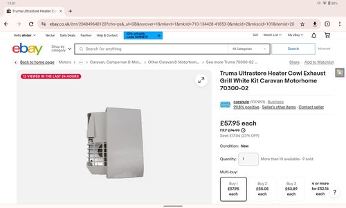

Have a look on the caravan wall outside normally a vertical oblong plastic box, 8" by 4" and should pull off from the bottom.
Maybe something like this.
