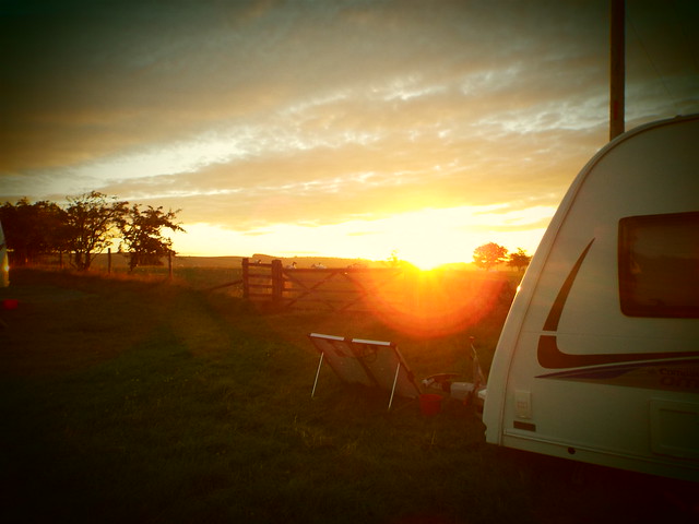

Just had 12 nights then a further 7 nights on Temporary Holiday Sites, I found my 150w folding solar panel did the job well and kept the 110amp battery fully charged. On first site did use TV with sat receiver for around 3hrs a night. Also used it in February for 4 nights and battery was kept charged up, no TV but Alde heating pump on most of the time. Turned panel 3/4 times, it got the morning sun at 7.00am between trees, then mid day, then evening.
http://www.renytek.co.uk/folding-solar-panels
Sun at 5.30am (dog wanted a pee!)
