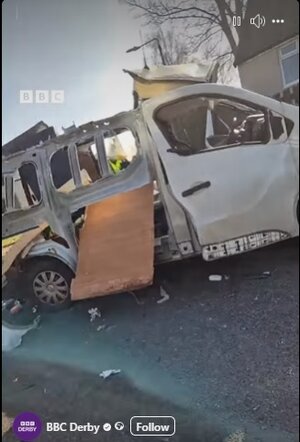

Yes Prof it's starting to sound like he is casting around in the dark and he should wait for the service.
Messing with gas can be disastrous. Campervan suffered LPG explosion , driver in hospital
In my time I have had to submit reports to inquiries on similar incidents, where the owner had indeed interfered with the gas installations. Fortunately no fatalities, but some serious injuries, including Carbon Monoxide poisoning.
