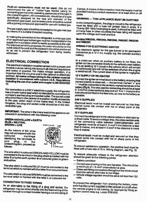

Because I don't know the make and model of fridge I cant be specific, but several models of fridge do need to have a 12V feed to control the fridges operation when using Gas or Mains electricity. Without the 12V feed the control circuitry will not work, and thus the fridge wont work on gas or Mains either. This could be your problem.

12V is run from car by separate circuit, not house battery, only used while tow.
Hard to fault find 230v over web but could be selector switch with poor connection. Mine stopped working on gas when I switched to 12V. Switching between 230 and gas few times and it came right, poor/dirty contacts on switch.

You need the 12v to operate the fridge whether hooked up or not.

Depends on vintage of fridge. But given his is 1998 very much doubt it. Both my 2000 and 2009 models were very much manual.
As you say its dependant on which model of fridge the OP has. There were models of fridges from about 1990 that needed a low current 12V supply to operate.

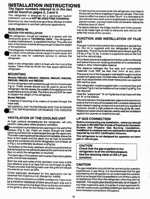

Please note when putting a fridge back you must ensure it is'room sealed', Any foam strips/sealant/trim panels you have disturbed must be reinstated. Including any heat deflector plates at the back. this is to stop combustion gases entering the habitation area when running on gas.Even if you don't intend to run on gas it must be done now.

Thanks for that, there was not any seals or foam around the fridge to cabinet. But it is going back to the 1998. Maybe I could inch the fridge out again and add a draft proof strip around the frame👍

Historically a number of caravan makers didn't bother to room seal fridges when they installed them - completely against the fridge makers specification and against safety guidelines.
