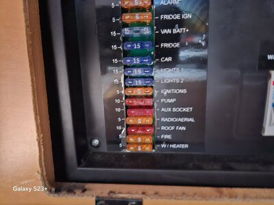

took a pic today so i can suss out whats what,i have attached a pic pardon my ignorance but can anyone tell me what the VAN BATT fuse is for?

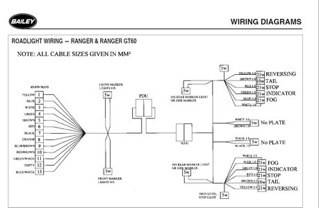

It could be a fuse for the VAN BATTery,These images are for a "2009" Bailey but may be of use.BAILEY RANGER WD M00_033814.JPG
Van Batt is the Caravan Battery , pulling this will disconnect the main battery positive connection from the rest of the 12V systems , apart from a retrofit solar panel and the motor mover connections. Not sure if the alarm also gets disconnected from the battery
cheers not gonna pull it just curious as to what it serves,,,cheers
