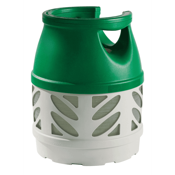

We used to have amagnetic indicator which was put on the outside of the bottle, Completewaste of money,
We have now, since the acute supply issues with Calor changed over to GasLight. The level of liquid gas can be seen through the composite cylinder walls - and two x 5kg cylinders weigh about thesame as one Calor 6Kg butane !

Thought the magnetic ones were a bit cheap.
Think i will go down the gaslite bottle route ,seems to be the best option.
12,071
4,236
Gaslites are jumping on the bandwagon for the cost of gas. A 5kg £35.
A 6kg calor (heavy) £26.75. but more realisticly £29.
I see you can get calorlites refilled on Ebay for £25.
