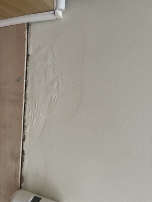

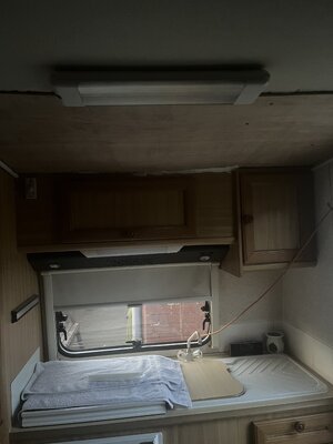

Hi I’m new to caravans would love a little bit of help I’ve bought a 2 birth Colchester caravan n I have no idea what the guy before me has done but it’s started raining and this has happened any help would be much appreciated thanks

Welcome to the Forum, sorry to hear you have damp, unfortunately it’s a fact of life in many caravans and not only older models. If it’s around the rooflight it will need removing, all old sealant removing and resealed and replaced. Hopefully the “damaged” area will dry out and not look too bad afterwards. Otherwise it becomes a much bigger job if you have to remove damaged roof materials and replace them.
If you are not up to replacing the rooflight get an Approved Workshop Scheme technician to do the job. Google to get the details of AWS in your area. A mobile tech could do the job. In the meantime you can use some duct tape to reduce water ingress. There are very effective sealing tapes that are designed for a more permanent result but I wouldn’t recommend using them unless you decided not to have the rooflight removed and resealed. Two good ones are Eternabond and Rooflock.

Thanks for your reply I take it the guy has just covered the roof light with the plywood? And the soft spot next to the ply is leaking down to that also? I’m not very good with diy never come across this before th ask again

I would dread to think what is under the plywood which should be removed for further examination. Water ingress doesn’t always appear at the point it enters it can travel via the structure.

Ah yes I didn't see the plywood on the ceiling of the caravan, looking closer at the photo. A photo of the outside of the roof could be helpful.

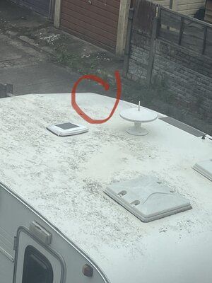

There’s also a little dip where I’ve circled, I’ve bought a right mess haven’t I 🤦🏽‍♀️

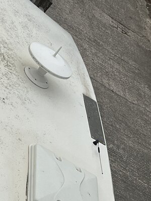

Well, don't get too disheartened, the aerial base could be leaking, that can be resealed, as OC states roofing tape such as Roof lock, along the side seams, could seal that area,
What is the grey section on the edge. ?

I’m unsure I thought the grey section was supposed to be there ahha

Sorry to say it would seem that the damp is very long term and likely affects the whole of this roof panel across the rear including through the corner washroom. Maybe the original ceiling board was wet and had sagged and was covered up with the sheet ply, but unless the source of ingress is corrected it will continue to deteriorate and spread along timber struts horizontally and vertically.
I wondered what the grey patch was - maybe at some time hit by a tree branch and caused a split and the dent you describe - so a good place to start - maybe you can effect a tidy job with some suitable automotive filler.
