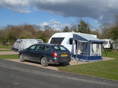

I had a 2014 Superb AWD estate and even after having everything checked her rear would sometimes bottom out coming off the drive or over speed truncated humps in our road when coupled to the caravan. Yet it wasn’t overloaded or excessive noseweight. I had MAD supplementary springs and it resolved the problem. They are fitted with a preload which increases unladen ride height by about 12mm. During their subsequent usage I never had any concerns over the car’s suspension, ride or handling. In fact that little bit of preload seemed to improve its solo performance. Mine were fitted by a rural Skoda dealer who had fitted them to other Superb estates. I bought MAD as I couldn’t find a way to safely buy official Skoda uprated springs used in Eastern Europe including Russia. I had used MAD supplementary springs on a 1997 SAAB 9000 CSE 2.3 turbo. Big improvement too.
Picture below shows unloaded car with MAD fitted.
Thank you very much. It’s just the fitting of them im
Not sure about, maybe just ask a garage to do them?
