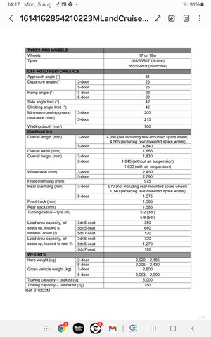

The important figure is the max authorised mass of the towing vehicle on its own If it is less than 3500kg then you start running into legality issues.
The maximum authorised mass of a Landcruiser (see below) appears to be 2990 Kg, so LESS than 3500kg, so it cannot legally tow a trailer over 7m in length in the U K That's regardless of what driving licence you have. If the rig isn't legal then any insurance (for damage to the caravan would be void as well.
So in simple terms you need to find a shorter caravan, or a much heavier towing vehicle, sorry!
Maximum length​
If your vehicle’s maximum authorised mass (MAM) is 3,500kg or less, you cannot tow a trailer that’s longer than 7 metres.
