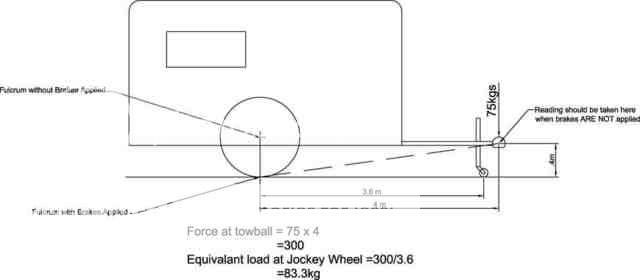

I can't remember my school day physics and the formula to work out force and leverage, but David's suggestion sounds like a really sensible and safe approach. I had never thought of doing that way either and have also struggled balancing a piece of wood on the hitch!!
Perhaps someone could remind us of the calculation to work out what the differnce in weight will be due to the difference in distance from the axle pivot point to jockey wheel and axle pivot point to centre of tow hitch.
The actual weight measured at the tow hitch must surely be slightly less than that measured at the jockeywheel due to the increased distance from the pivot point.

No, Adrian, you've been doing it right (except that the caravan shouldn't be level unless it happens to be level when hitched up to the car, too).
Measuring with the jockey wheel on bathroom scales is only an approximation and will lead to the actual noseweight being somewhat less than what you measure.

Here's the calculations based on my Bailey Ranger 470/4
I hope the picture works!!

Thanks for the calculation Reg.
I couldn't remember if it was force x distance or if there was a square of the distance in there somewhere!!
