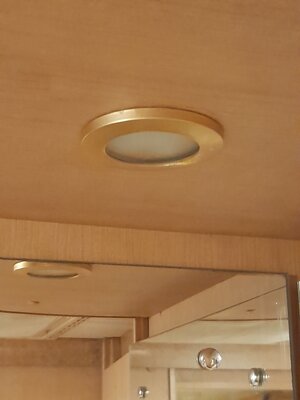

M Mark_Inder Sep 4, 2024 22 8 15 Sep 28, 2024 #1 I have an Abbey 215 GTS with a rear bathroom. The recessed light in the toilet has stopped working. How is it replaced/fixed / whatever?? I can't see any obvious ways to gain access to the bulb. What really simple thing am I missing? Attachments 20240928_201626 1.jpg 661.1 KB · Views: 1
Jcloughie Jun 16, 2020 5,848 2,770 17,935 Sep 28, 2024 #2 These normally simply pull out, take a blade and put it between the ceiling and the fitting and gently lever it out. Then the method of changing should be clear. John

Beachball Jan 3, 2012 11,220 2,649 40,935 Sep 29, 2024 #3 it might unscrew /if does not pull out but you can check with your caravan handbook
