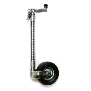

I would stand on the jockey wheel lever in order to tighten it up. Worked for me. I have heard that some put a cable tie around the shaft to prevent it dropping, but that needs cutting off each time. If you want to splash out, you could get a notched wheel assembly. Not used them myself, but they look sencible. (The pic is just an example).
