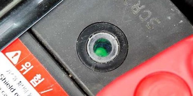

It also has the indicator on it which says
green ..good
Red......Needs charging
Clear... needs changing
Mines clear.

The indicators are pretty meaningless TBH. They are located on one cell which doesn't really give a reliable indication as to the health of the whole battery.
Looks like you are close to getting sorted though.
