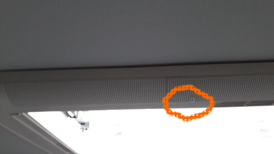

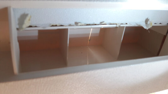

It could be that the surround on the Heki has cracked. It is normally a straight line and looks almost natural and invisible. .

How bad was the water ingress? In certain conditions of wind and heavy rain , water may get through between the roof and the frame ridge directly beneath the plastic dome. The dome does not give a water tight seal
