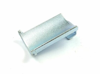

After undertaking some fairly strenuous motor mover movements to get on my driveway recently I suffered slippage in my jockey wheel clamp a number of times also taking a lump out of the tyre. I also noted the clamp had gotten bent though not sure if it was all as a result of my maneuvers.
I was somewhat miffed to find that ALKO does not actually sell new clamps, and I had to purchase the nearest thing visually which was not for my individual van.
During my searches it was conveyed to me that I must have lost the pressure pad from the clamp, I had never heard of or seen a pressure clamp and definitely did not have one when I changed the JW.
I bought one of these pressure clamps and surprise surprise I can't get the JW stem in the clamp with the pressure pad present. Does anyone currently use these pads and on what caravan?

Logically if the JW clamp slips it can only be one of three things, either the clamp was not tightened enough, the load on the nose is too great, or the JW system is damaged in some way.
18,437
4,257

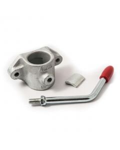

Is your JW side or centrally mounted?
There are a number of different fixings depending on year and make of caravan.
Ive seen one like your photo but can’t say mine has it..
Is yours more like the pic below, usually a centre fitting? Note the pad is a lot smaller than your photo.
That said it has to understand why the JW slid through the bracket. ??
Have you tried contacting Al-ko direct for the missing part?

Mine is a side-mounted clamp, swing-open variety. The securing base is welded to chassis. Not the same as your picture. I have to assume at this point my weight must have been too heavy, the Karrt JW which was brand new was rated at the higher nose weight but was not their ribbed variety.
