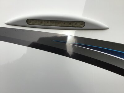

Has anyone changed an awning light(actually a service light for the water butt)I can see where the wires are but not the fixing screws,are the on the inside or are they hidden on the outside of the fittings with cover plugs on?Caravan is a Lunar 574,2017

If you can't find any screws the light may just be bonded to the side of the caravan, if it is you may need to use something like dental floss to 'saw' through the mastic or whatever has been used to free it,and then it will need cleaning thoroughly before bonding the new one in place.

I have managed to find the light,Dimatec £32.00 off eBay,the outer shell is press fit,the screws are on the fixed part,thanks for everyone s input
