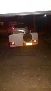

After reading all this about wiring situations regarding LED lighting I was a bit dubious last night when I came to hook my trailer up which has just been renewed with LED light boards at the back but all works , I have no beeping in the car but every light works as they should .
