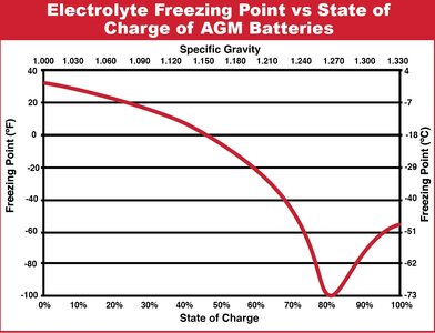

I was thinking of a plastic box, won't the battery freeze out in the shed?

They're fine as long as they're kept reasonably charged, but will freeze if allowed to discharge too much in freezing temperatures. To be fair, if the battery is allowed to discharge to the point that it will freeze in the UK it's likely to be damaged regardless of the temperature.
