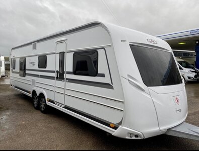

Hi I have inherited an lmc exquisit VIP 685 caravan i own a ssangyong saracen with a stage 2 plate can anyone tell me if I'm legally allowed to tow this rig in the uk
I have a C1+e license

You also need to check the external body length of the caravan - if it's over 7.00m it can't be towed in the UK by that towcar.

As its body length exceeds 7m (excluding A frame) I believe you would need a vehicle with a MAM exceeding 3500kg, IE a commercial vehicle. What did your relative use to tow it with? Also be aware that such outfits aren't welcome on many sites because they think the owners may be Travelers.
