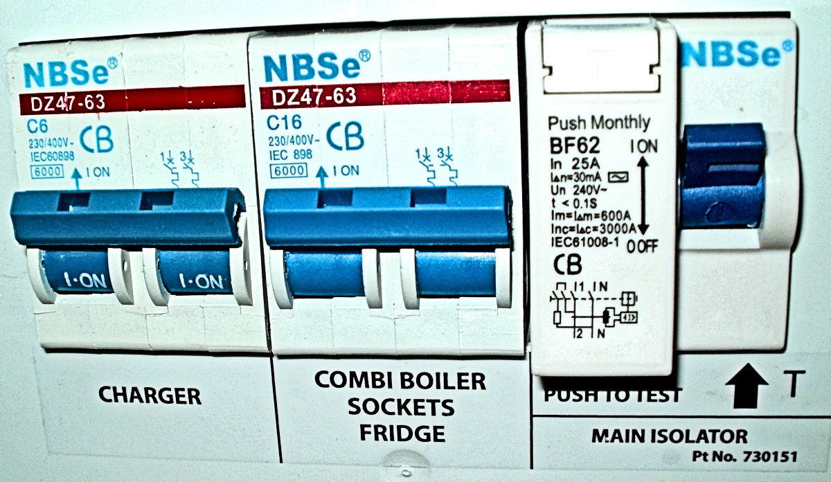

I have a 2013 Bailey Unicorn 2. When looking at the wiring diagram I noticed that both the 10 amp MCB and the 16 amp MCB both have boiler connections. Is the 1kw element linked to the 10 amp and the 2kw to the 16 amp?
Just wondered as to why the boiler is split to both. Thanks for any advice

I would suggest that the mcbs are not marked up correctly. Take a look in your caravans documentation for the Electrical Installation Certificate, Look at the circuit details and test results. It should be quite clear on the results as to the duty of each mcb
Could it be the igniter for the boiler is on the lower rated socket, the heater element on the larger one? Just guessing mind :cheer:

I would agree with you both! I had a look and this is a printing error.
Please see below link of the MCB's in the van and how it does not match with the diagram
Hmm C16 mcb, no discrimination there then. This means if you are only on a 10a site supply bollard in the event of a fault the site mcb will allways trip first, if you are even on a full 16a supply the site bollard will allways trip first because the fault current has to pass through the first protective device first. 10 amp mcbs in the caravan make more sense.
Wrong !,with two circuit breakers of the same rating connected in series there is no certainty the circuit breaker closest to the source of supply will trip first.
Sorry I do not agree, Been doing this Electrical work now for 44 years. I mention the term Fault current and not Overload current, think about it.
