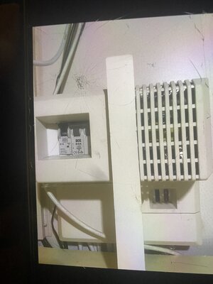

hello i’m very new to owning a caravan.
i picked up fendt platin malpet which my son and his girlfriend are using on our driveway whilst they save up for a house.
whilst going over it finding out how it works i noticed on the main fuse box in the wardrobe that the 10amp fuse had melted but. not blown, so replaced it and again this evening checked to see that it had melted again.
the wires seem cool to touch and are. not melting i think the 12v system may of been moved to the bedroom area under the bed.
any idea what could be causing the fuse to melt because i’m not to keen on letting them sleep in it if there is a chance of it setting on fire.
below is an image of the fuse box.
tomorrow i’m going to go over all the 12v setup, under the bed is an old car battery which we are going to replace for a leisure battery a 12v charger which i’m replacing tomorrow for a more modern trickle charger and the unit that moves the wheels via a remote..
any advice would be appreciated.

They are not fuses but rather miniature circuit breakers (MCBs) which are effectively resettable fuses. However such devices are normally found in the mains supply circuits and conventional fuses (i.e. car-type fuses) are used in the 12V circuits.
Given you are having an overheating problem and mains kills, I would suggest you get someone who knows what they are doing with mains - better still but not mandatory with caravan mains - to check it over.

I am concerned when you say there is a 12V battery under the bed. Lead acid Batteries should be in a room sealed box such that any escape of gas is only vented out side and not into the living space of the caravan. The 12V wiring should be protected by a correctly rated fuse (typically 15 to 20Amp)
As Woodentop has stated the devices in your picture are Miniature Circuit Breakers (MCB's) and are rated for use on 230V ac circuits. They may not function correctly on 12Vdc circuits.
You are correct to be concerned about th e problem your having, as whilst 12Vdc does not heave enough potential to give anyone an electric shock, but the current available form a battery is more than enough to to cause a fire.
My advise would be not use the caravan until the 12V wiring has been fully sorted out and at least checked by a professional caravan engineer.

in the image above yes there are 3 mcb which are fine, but if you zoom in and look under where the grill part is you will see 2 slots, one is empty and a type of blank area, the other in the right is where a 10 amp blade fuse is, and that’s the one for some reason that keeps melting but not blowing.
19,275
4,465
Do you mean the coloured plastic moulding around the the metal blade fuse link is melting?
If that is the what happening, then clearly the something is getting too hot, and its most likely a poor connection of the wires to the fuse holder, or the fuses contacts with the fuse holder.

yes it’s the red plastic around the blade fuse that is melting, the metal part of the fuse stays intact and doesn’t pop,
later today i’m going to trace the wires from the fuse box in the wardrobe back to the battery and see what is actually running of the 12v , i think it’s just the taps and the internal water pump and some lights around the roof vents.
i shall look out for some loose connections as the actual box that the blade fuse go into is a tight fit and doesn’t look damaged from heat or anything.

I agree with ProfJohn on this one. First thing to do is clean the contacts on the fuse holder. Try folding a small piece of emery cloth and work it in and out of the fuse holder where the fuse legs go in. Next check the connections on the back of the fuse holder. It's likely to be a couple of spade connectors and if one or both of them is a poor connection you'll know straight away as it will be discoloured.
It's possible that you are close to the limit of the fuse carrying capacity. If you don't have a meter to check this try replacing the 10 Amp fuse with a 7.5 Amp fuse. If it blows you're on the limit and the fuse itself is getting hot. If it doesn't blow but the plastic still melts you have a bad connection.

I personally don't think it's a case of the current being drawn exceeding the fuses rated value, becasue the actual fuse wire has remained intact. It's perfectly possible for a modest current that is well within the rating of the fuse to generate heat if it encounters a (relatively speaking) high resistance.
Such as corrosion on a contact or loose or damaged wire. localised heating will occur, so for it to affect the fuse carrier the fault ahs to be close to th e fuse carrier, and a high probability it will be the fuse receptacle connection as they will be close enough to transfer the heat to the fuse and melt the carrier.
One of the risks is the localised heating may have annealed the contacts and they may no longer grip th e fuse blade properly. Th e fuse receptacle should be treated as suspect and probably need changing.
