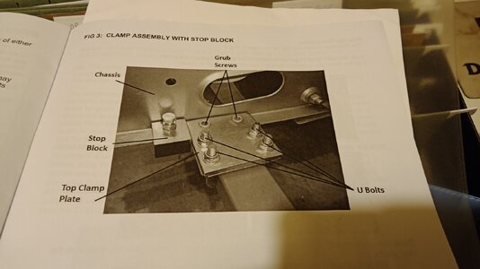

I don't recall seeing Allen screws! When you say "retainer plate", do you mean the separate block?
No, the main upper plate where the two "U Bolts" go up through, you might need a mirror to see them. The screws come down from the top nd then grip onto the Alko chassis. IMG_20230902_202056_619.jpg
