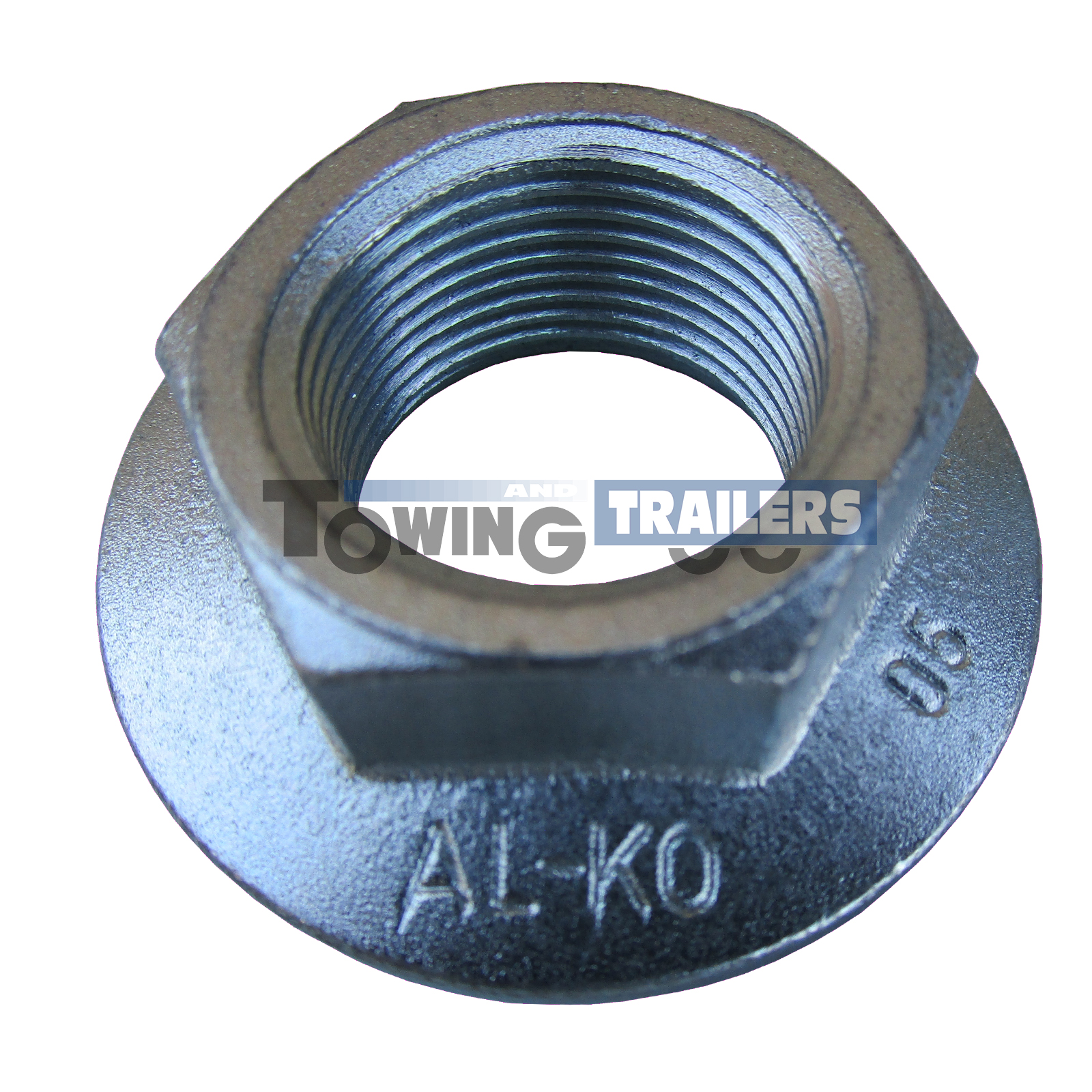

Hi everyone,
I am new to this forum and would appreciate some advice please.
I have a 2013 Swift Challenger van. I reside in Australia and at times because of the low number of these vans in this country, I struggle for competent advice on issues from time to time.
My question in this instance, can you please inform me of the part number and size of the one-shot nuts to suit my van. Once I obtain this information I can then research availability.
Many thanks in advance.

These are the ones fitted to our 2018 Challenger 530 (UK spec.)
That link gives the following info.
Our part no. OSNALKO32
Manufacturer’s part no. 581200
The above may (or may not!) help.

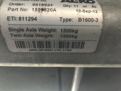

Since this post I have had some success. I have managed to get a couple of part numbers from Al-Ko International here in Australia. There are two sized nuts, 24mm and 27mm. I just have to determine which size is applicable to my application. There are a couple of ways of doing this, one by measuring the thread on the axle or easier still, taking the part number off a plate that is fixed to the axle from which all associated parts are identifiable.
Thank you JRT, that throws another size into the equation. My van is a 2013 Challenger Sport, you would think that a simple one-shot nut that fits your van would still be applicable to mine.

It has been a learning curb for me in the past couple of days resulting in further information that may be of assistance to members trying to ascertain the correct part number for parts relating to brakes etc. Some may already be aware of this hence this information is for those who don't.
This information relates to Alko brakes
On the axle (s) of your van, there is an identification plate with a series of numbers. The important one is the area with the inscription ETI: followed by a number. Enter this number.
In my instance, I googled Al-Ko ETI 811294 Information. I then clicked on Trailer Plus which displayed a schematic blow up of brake parts.
Hope this assists
